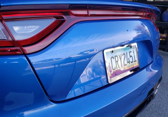

First, the process of removing the rear emblem. I finally decided to go for it. I stuck a space heater pointed at the emblem for about an hour, and then would pry/spray goo-gone in alternating intervals every 5-10 minutes until the badge came off. I then used a sacrificial micro-fiber towel and would spray the residue, wait 10 minutes, and wipe up. I repeated this about a dozen times until the rear panel looked clean. I then took my buffer to the rear panel and polished it all out. The final result:
In the photoshoot, the new badge had been installed, so refer to my previous post for an after picture. :D
