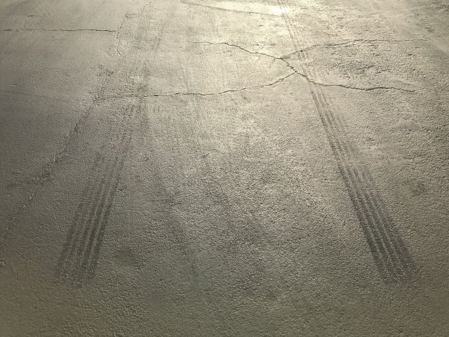

Question...My understanding is that unless you bought a GT2, all 2018 GTs had a peg leg rear diff (one wheel provides traction). How is it that I just laid 2 tracks?

That is interesting, maybe you have an anomaly:unsure: @CKeeler

I dont see anything wrong here.
Just smiles ;)

I thought it was interesting to see. I’ve had three Mustangs with open diffs and none of them laid tracks like this. Maybe I’ve got a special one. Yay me!

LSD was an option on the 2018 GT. Do you still have your Monroney window sticker? If so it should be listed if yours has it.

As far as my understanding of it, 2018 GTs equipped with the safety tech package and GT2s were the only ones with Limited slip. I’ll have to dig out my window sticker and see what it says

Both an open differential (peg leg diff) and an LSD Power both rear wheels.
The difference is that when one rear wheel spins faster than the other, the LSD will lock and both wheels will get a similar amount of power. So you see two spin marks at most times when there is wheelspin.
An open differential will also make two spin marks as long as the rear tires have similar traction on both sides of the car. However, if one rear wheel has significantly less traction than the other, the wheel with less traction will receive more of the power distribution than the wheel with traction. That leads to the low traction wheel spinning/slipping (leaving a mark on the pavement) and the high traction wheel relatively unpowered and just along for the ride (leaving no mark).
Just remember that regular diffs power both wheels evenly until one starts spinning faster than the other, then that faster spinning wheel receives an ever increasing amount of the rear ends power.
LSD addresses this by mechanically locking the wheels together in situations where one wheel might spin faster than the other.
