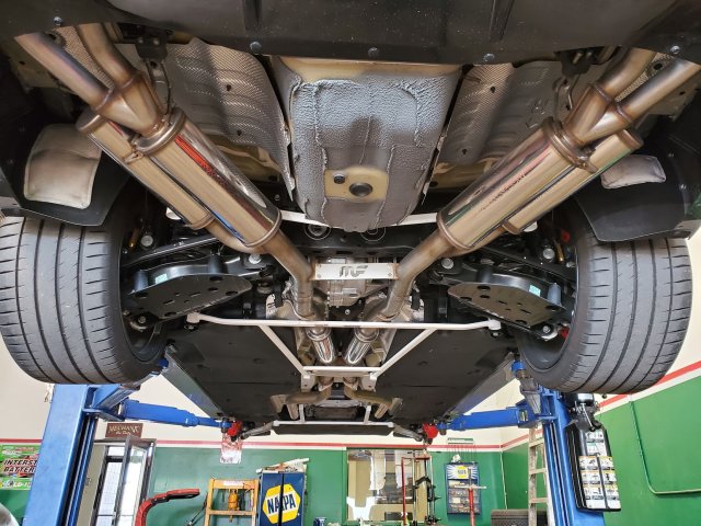

I do believe one person has installed a 305 on the rear but I think he had to run a spacer. I run a 19x11 50 295 on the rear an I barely have any room between the tire & shock.

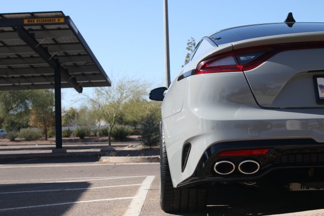

The specs on wheels are 19x11 5x114.3 ET 50, there are a few guys that have 295's on 19's or 20's x10.5 with a 45 to 47 offset. It just depends on how much of the tire you want to stick out, I have like 1/8in sticking out, here's a couple of pictures..

You can run a 295 on a 10, just make sure the offset is cut right. I had my wheels cut for my car..
