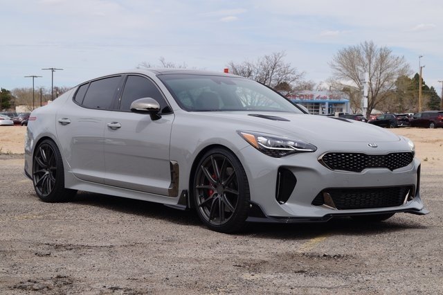

Wheels: TSW Nurburgring in Matte Gunmetal, 18x8, +35mm offset front, 18x9.5 +40mm offset rear, special order gunmetal center caps
Tires: Nitto 555 G2, 245/45/18, 275/40/18
Suspension: stock
The rear comes very close to lining up with the wheel arch, so lowering might be a problem. There's room for a deeper offset, but that's as good as I could order.

Wheels look great on your car (y), I'm just asking but why did you go with the 18s an not the 19s?

What was the cost of those wheels with the special order color?
I like rubber! Don't like the ride quality of tires below a 40 series, and prefer this kind of look. I'm an old school muscle car guy, so moving from 14" rims to 18" rims is enough evolution for me. :D
I also think the semi-stretched look of the stock PS4s is awful. And I tore THREE front right tires on potholes around here.
The wheels are stock items - generally $308 each. Check the TSW site - they come with these awful bright aluminum centers. My vendor (getyourwheels) charged another $100 for a set of gunmetal centers from a different TSW wheel.
